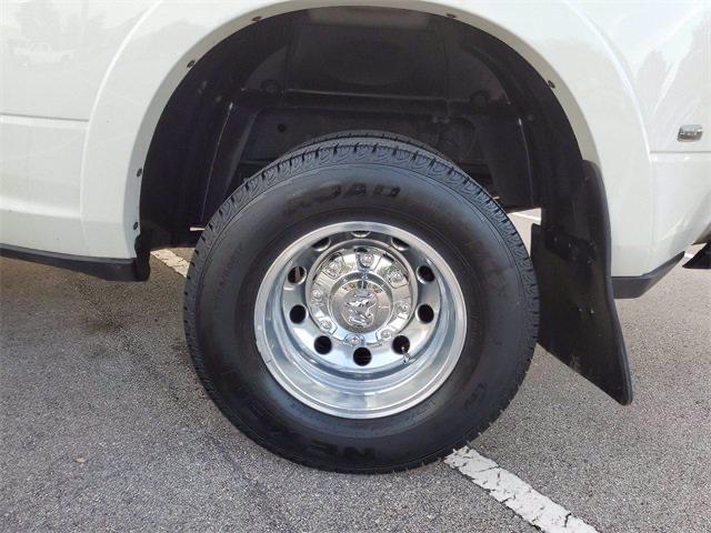

I found a 2021 DRW longhorn on auto trader just now. Luckily the dealer took a great picture of the rear dual fender well area. You can clearly see the center section installed, even that oval shaped depression in the center of it, which matches the part I posted initially.
So I just left the dealership. They did indeed order me splash guards, however the ones they ordered are the ones that are already installed on the truck, NOT the small center piece that spans the gap. In speaking to the parts guy, and also observing his parts program while he was flipping through it, the parts catalog shows the center splash guard (#4 on the diagram) but does populate a part number for a 2022 model year VIN. Once he switched it back to a 2021 or prior model year, a part number showed up. Apparently for some reason Ram must’ve made the decision to pull these from the truck equipment starting in 2022. No idea why.
In any case, the correct ones (from a model year 21) truck are ordered and should arrive in 3-4 days. Not sure how this is going to work out in terms of paying for them, but if I need to I’ll buy them myself and install. I see no logical reason why they weren’t included in the truck, especially since they are still being produced and are available. The part number for the splash guard center section is 68061033AA
You will need two of these, one for either side. Additionally you will need four Phillips head expansion screws (I will get part number when I pick them up in a few days) as the lower part of the shield connects to the main splash guard via these screws. The upper part “hooks” into the panel with the pre existing square holes.

Talked to the dealership about the missing part. According to the GM (so take it with a grain of sand) the center piece is now a stand alone option that now has to be selected but doesn’t show up on the options list. I had to give the the part number before they could even find it. They will be ordering me replacements at their cost. Can’t even guess why Ram would do something as foolish as this but is getting to be no surprise. Once they come in and are installed I will update if they are the correct parts.
Thanks for all the info a research everyone. Can't believe they have to be ordered separately, and its even harder to understand why they don't just come as one solid piece. Even with these add on sections, there's still a huge hole on top. I would love to know why they designed them to not be full coverage.
