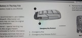

They all have a key in the fob…. And all the 19+ hd trucks are push to start
I don’t believe the base chassis cab is keyless. This is the only model that Bolt offers a receiver lock for.
unless you have the keyless option.
The 2500 and any other "keyless entry" style remote always have a back up key built into the fob for access to the vehicle. So yes, even though you have the "keyless option" your fob will still have the "emergency key" to use for the Bolt hitch lock.
