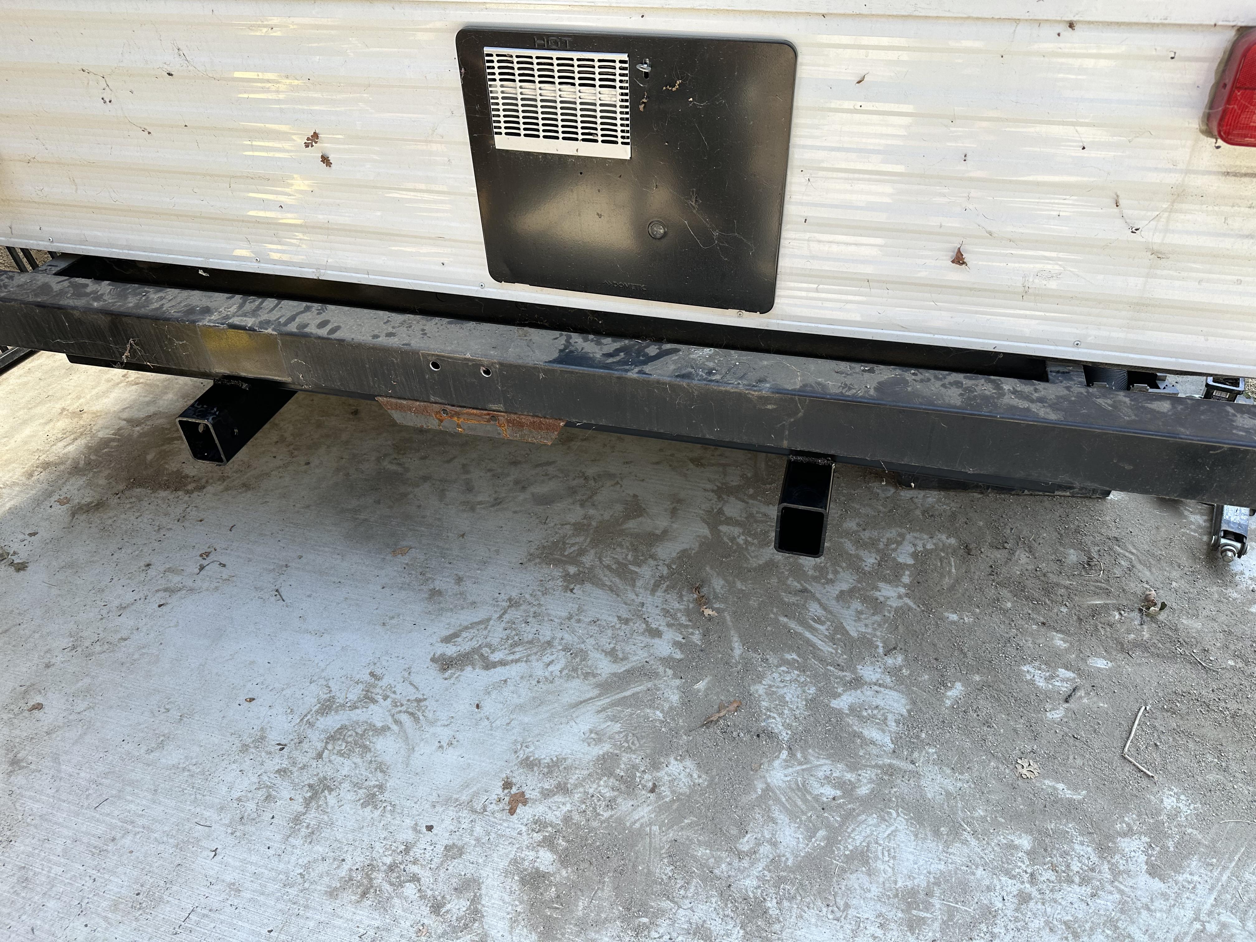

Whatever you do, do NOT depend on a factory trailer bumper for any attachment points, they can barely hold up a bike rack. Tow receiver needs to be solidly mounted to the trailer frame - bolted on/welded or both. I'm a fan of bolt on unless the frame as a large thick I beam. Been running my custom fabricated bolt on 5K rated hitch on 2 5th wheels now since 2004. Curt makes a pretty decent bolt on setup that can be fitter to most any trailer (they have different models) if you're not one to fab something yourself.
With lighter weight trailers with thin C-frame, you should probably reconsider, or at least consider extending some extra steel up past the axles. Low tongue weight towable like small aluminum boats or anything ~1500-2000 lbs max shouldn't put a lot of vertical flex into the front trailer.

Definitely not an airstream, it’s a standard camping trailer 7k rated frame 2 3500lb axles. I went and checked out the frame a little closer, I’m actually pleasantly surprised, probably because I was expecting to be disappointed, but the frame is 6” I beam looks to be around 1/8” thick all the way back with decent cross bracing. The camper has a fairly light dry weight of 4385lbs and a cargo capacity of 2615 so it’s not one of those campers that are rolling out of the factory with 500lbs of capacity left. The only time I weighed it all loaded up it was just over 5500lbs and that was with only enough water for bathroom breaks on the road. So with full water tanks (500lbs) and extra riding gear put under the bed I should still have 750-1000lbs of capacity left in the frame for the for the freedom hauler.

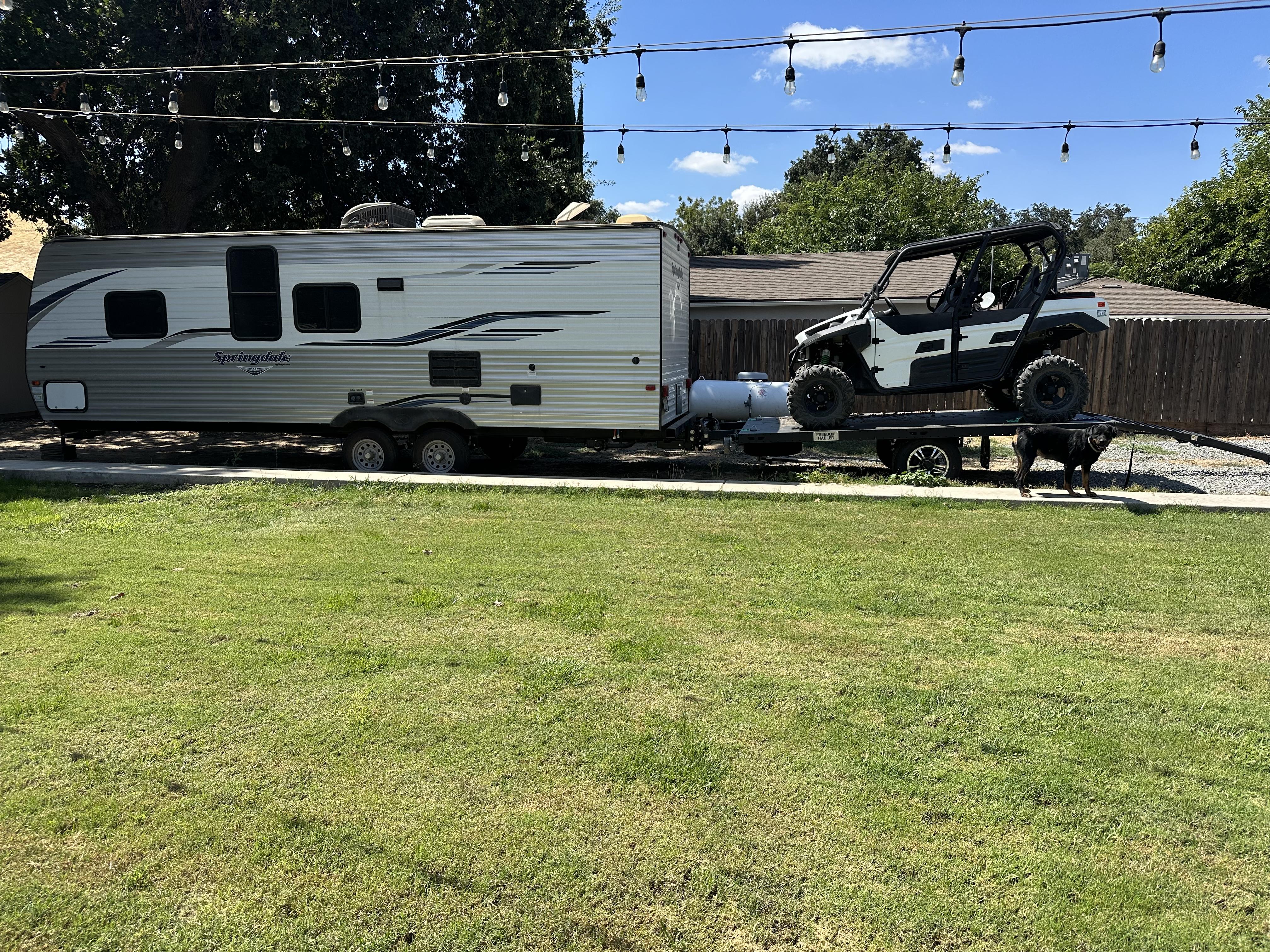

Dog is looking like...I hope he lets me ride in the truck!!Used my day off to get the bracket made and everything mocked up. Still need to get the 7 pin wired to the back and add the rear view camera to the trailer. This set up is 43’ 6” tip to butt and with my truck and hitch I’ll be right at 65’ long just like I thought. I still need to adjust the front of the dolly up a little bit I wanted to load up the utv and see what everything looked like.
