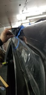

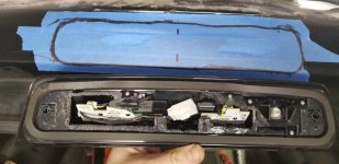

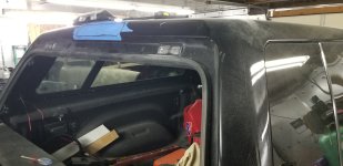

Just wanted to sign up so I could thank you guys for the research and posts on this, used a lot if it to get my digital rearview on my '21 operational again. I bought the factory CHMSL with rearview camera only (P68465996AA) from a salvage yard and integrated that into the back of my topper. Had to trim the assembly down and router out the fiberglass to get the angle correct. I really am glad to have the digital rearview camera back and look forward to using my switch with the other one I put on my 28' cargo trailer. Thank you all.
View attachment 50764View attachment 50767
Do you have any more info or photos of the install and modification? Looking to do the same with an ARE topper.
I took a couple. First I made some modifications to the back of the lamp to give it a shallower depth. Then I made a template of the part that needed recessed and transferred it to tape on the topper, there were several test fits. I pulled the rear glass and that let me clamp a couple of 1/2" boards to the proper angle for the router which let the lamp assembly to sit as flat as possible. I did trim down the upper lip of the housing so it wouldn't get caught going through car washes etc. The topper isn't thick enough to get the lamp wouldn't sit all the way down without it being a clean cut all the way through (which I didn't want). Here's the pics I have on my phone, if you need some finished ones I can grab some.
20230115_095116.jpg20230115_095127.jpg20230115_095344.jpg20230115_101029.jpg20230115_184954.jpg
View attachment 73493View attachment 73494View attachment 73495View attachment 73496View attachment 73497
