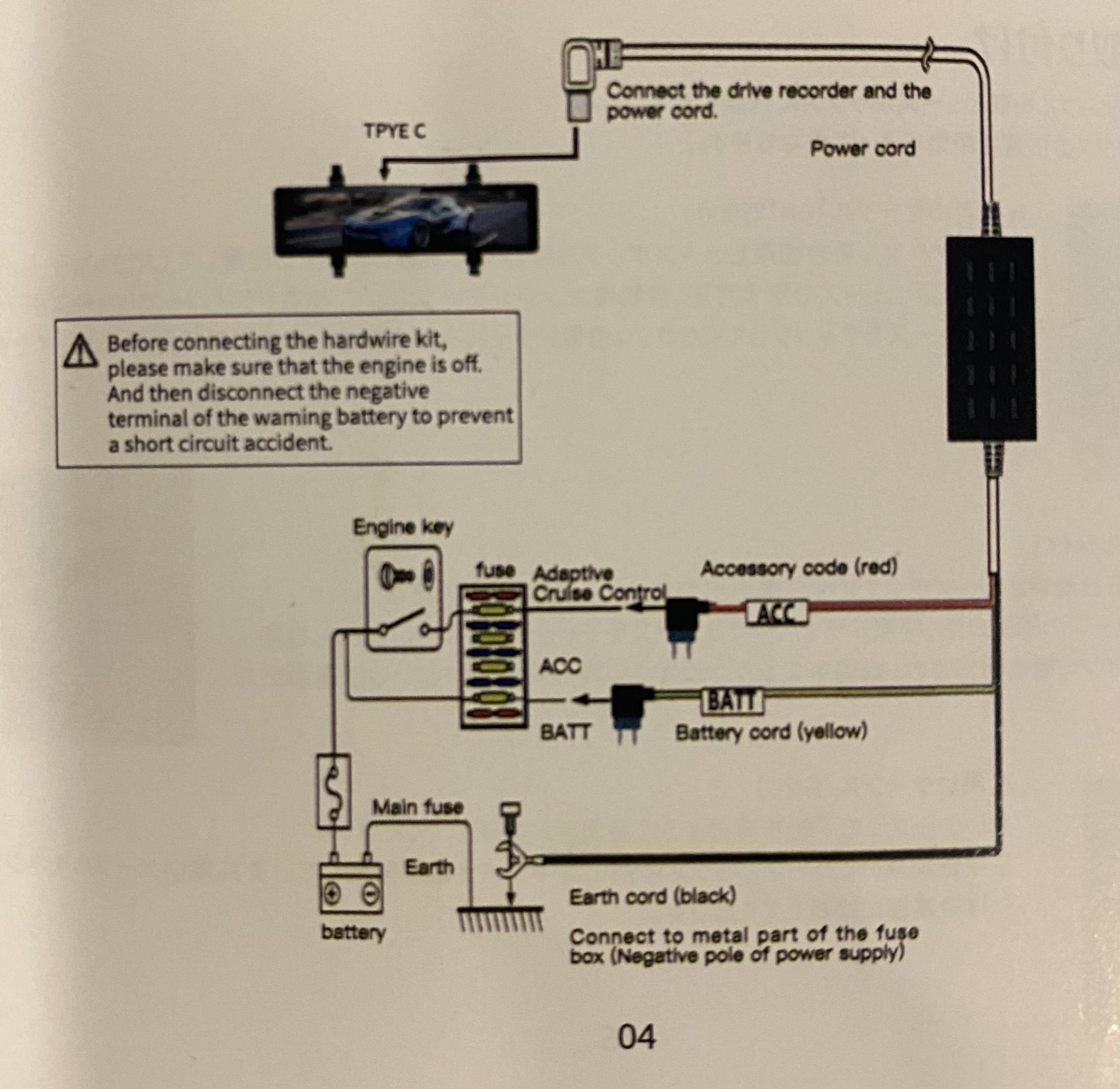

Where did you locate the fuse block?I have the two wires de-pinned but can’t find a good place for the fuse block. I am using Stackable Add-on fuse block so I can hook up both the switched and battery supply line so I can use the parking mode of the dash cam.I used my IGN+ and BAT+ from the jumper for the dash cam, but I'm going to add in a fuse block so I can also still bring IGN+ and BAT+ to the blunt cut wires in the back.

Can I put the 5amp fuse that came with my dash cam in the fuse block for switch number 6? If I leave the original fuse in place, what would it do, or cause with regard to the dash cam function? Blown fuses, over heated wires, et cetera.
Do not replace the AUX fuse with the dashcam fuse (if even the same type). AUX1-AUX6 can take any of the fuses in the PDC (you can move them around) as long as you don't exceed the total allowed load on the PDC. Put in the lowest fuse that's in there (10A?) and leave your camera inline 5A fuse on the camera power wiring.
If your dashcam has park-mode, you'll want to wire that up to constant 12V.

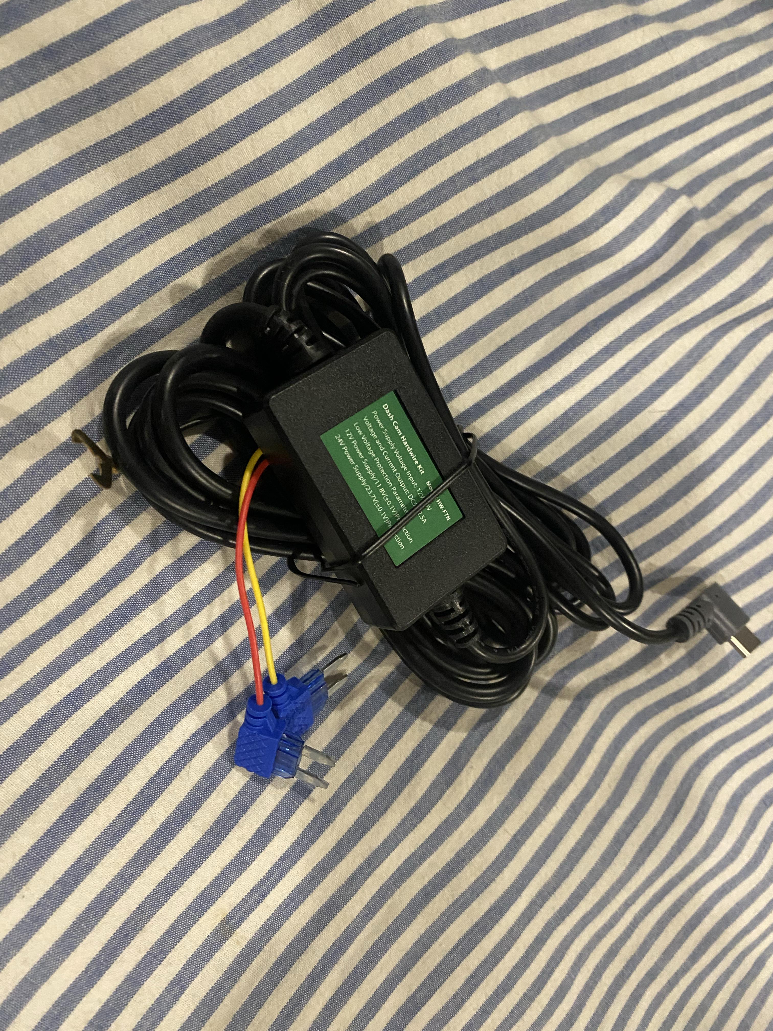

I need another assist please. Current state; dash cam accessory wire (24 awg folded for connection (red)) connected to pigtail (Ram 12 awg) and plugged into Aux 6, dash cam battery wire (24 awg dead ended to not create short or ground (yellow)), black ground connected to body ground. Aux switches in OEM configuration. When ignition powered to accessory - dash cam does NOT power up, when engine running - dash cam does NOT power up.
Connections checked / crimped completely (slight tug test, no wire movement). Verified good solid "click" when connecting to Light Gray Aux connector. As you recommended, no fuses replaced and inline fuses provided with dash cam still in original condition / location.

That grey jumper plug is also what brings power to the rear frame blunt cut Ignition and BAT wires. Explains why I've seen a few posts of owners not measuring any voltage there.
De-pin #1 and #4 if you need ignition or BAT inside the cab. I will probably use those for my dash cam.

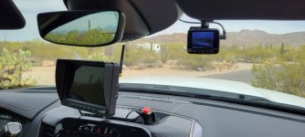

I used the Dongar adapter when I installed my Rove dash cam. Picked up a short right angle USB cable on Amazon to minimize the cable run and it works flawless, never worried about the constant power for the park mode as I rarely park anywhere to worry about it.I got the same Redtiger F7NP camera for Christmas. I found an adapter on Amazon, SimpleUSBPort Dash Cam Power Adapter (10-pin Type D) https://a.co/d/3Pix5Ls, I'm going to try. I think it was mentioned somewhere on here. I'm going to try the parking mode, if I can find a constant +12 in the mirror or overhead console.
