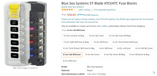

I used my IGN+ and BAT+ from the jumper for the dash cam, but I'm going to add in a fuse block so I can also still bring IGN+ and BAT+ to the blunt cut wires in the back.
I used the pas-thru circuit to bring AUX6 back into the cab for my 2-LO box.
I found this one with 6 separate circuits that can be slaved together as needed. It actually measures on 5Hx2W.
