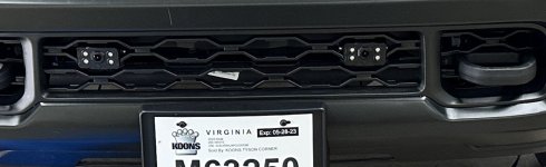

To mount the cameras up front I made a bracket from material on hand that day, planning it just as a template, and I would pick up some aluminum stock later to permanently mount. The template worked too well so I just painted it and rolled with it. If you have been following along you'll recall I forgot to order tow hooks with my truck so I pre-ordered hooks and bolts and the correct lower grille for tow hooks so I had no qualms cutting into my lower grille as I have a replacement on hand if it all went wrong, it didn't. I still have the lower grille as I chose to cut out for the tow hooks as well versus the more-open correct grille for tow hooks. Simple cuts with a hacksaw blade. Not much removed at all.

Front Cameras:

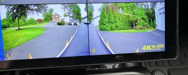

And with those cones in place, as close as they are, here is the view in the monitor. It's approx 2 foot at the corners from the bumper, and straight on, you can't get much closer, handy for parking the long boy. All 4 cones from above pics are in view.
In the rear I've placed six cones around. In conjunction with the reverse camera in the truck I think its pretty good.
And those cones as seen in the monitor. Obviously they are very low so if I can see them, I'm happy.
