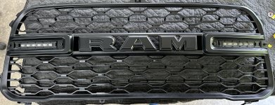

Installed the Rough Country 1500 Grille lights. It was an all day lollypop of a project but I love it. Full how-to details at https://hdrams.com/forum/index.php?threads/grille-lights-from-rough-country.11979/post-265002

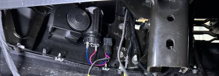

Saved all the wiring for last. I'll be making all my connections on Aux 1-4 on the front. Stay tuned for that. A bunch of mowing needs to happen first.
Aux 1. LED Fog Lights
Aux 2. Rough Country Grille Light Kit for Ram 1500 6"
Aux 3. MandR Automotive 30" Light Bar
Aux 4. Front mounted electric Train Horn
Aux 5. Rear mounted electric Train Horn (too high of an Amp draw for one switch)
Aux 6. Rough Country 10" Slimline Rear Auxiliary Lights
Get ready to work dual alternators:p

How bad was the modifications to get the 1500 grill lights to fit? I really want these but have been hesitant to tackle the job!
Mounted these up, 8,000 lumen for the pair. I like the length vs a cube size/style light. The provided brackets can be used 2 ways, I chose the orientation that results in nearly a flush mount.
For the look, the price, the warranty, I don't think you can beat these.
Powered via Aux 6 / Red/White/ Battery
A decent harness with relay/switch/fuse/etc is included, chopped up and just used the connectors at the lights.
I have them aimed higher rather than ground focused, happy with the resulting light spray.
Got a shot full dark this time.
Pleased.

Do you think there is a way to aim them down any?
You would have to cut much more structure when installing. If you looked at the install pics thread I am referring to cutting the high side to be the same height as the short side. That would get you a lot of adjustability. It’s do-able….. but, not going to be adjustable after the fact, meaning, set them where you think you might want them, reinstall grille, pull grille back off to adjust again. So during the install before you completely put it all back together, grille on and off is easy if you’ve planned ahead with a quick disconnect for wiring. The tightening of the screws that hold the light to the faceplate (and allow for adjustment) are not accessible after grille is installed.
For more adjustability vs locked in place.IMG_1641.JPGIMG_1680.JPGIMG_1681.JPG
