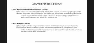

Just an update. I got my car insurance (USAA) involved. They took a sample from the truck while it's with the dealer. Just got off the phone with them and they are stating that they found diesel with no other contaminants. I am waiting for the test results to be emailed to me. Once I have that in hand, I can approach the dealer but at this point, I don't trust them one bit.

Here’s a screenshot from the report:
Any suggestions for how to approach the dealer with this?
You may want to just go straight to Stellantis corporate with that and let them sort it out... And you might want to request a free tow to a different dealership since this one is clearly playing games and you don't trust them with your truck.

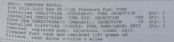

I want to follow up with an update. After my insurance company presented their findings of non-contaminated diesel, and I requested pictures of the FQS solenoid and screen, they determined that the HPFP did in fact implode and have moved forward with the repair at no cost to me. I picked up the truck today and am reviewing the paperwork (screenshot attached).
  • It appears that they used HO injectors but I'm fairly certain that my engine is SO. The kit they used is the CSRLY782AA which has the HO injectors. Should I challenge them on this?
  • They installed a fuel pump / level unit 5145571AA which never appears in the Dealer Service Instructions so not sure what that's about
  • It says nothing about flashing the PCM so I need to verify that with them.

HO injectors in an SO engine may be an issue for the DPF i would ask them about it….
Last I looked the duration tables are the same SO vs HO, which tells me the injector is the same... but maybe there is a different spray pattern for the SO piston vs the HO piston?
I didn't realize the injectors were different, but here's all the part numbers
(singles)
Cummins:
5364205NX, 5364205PX, 5364205 (Standard Output)
5364204NX, 5364204PX, 5364204 (High Output)
Bosch ® Part #
0445124047, 0 445 124 047 (Standard Output)
0445120039, 0 445 120 039 (High Output)
Mopar:
R8504672AA, R8444791AA, 68444791AA (Standard Output)
R8504671AA, R8444790AA, 68444790AA (High Output)
NEW BOSCH 2019+ 6.7 CUMMINS STANDARD OUTPUT INJECTOR SET | 0445010874, 68444791AA , 5364205 | 2019+ 6.7 CUMMINS​
SKU: 0445124047
NEW BOSCH 2019+ 6.7 CUMMINS HIGH OUTPUT INJECTOR SET | 0445120039, 68444790AA, 5364204 | 2019+ 6.7 CUMMINS​
SKU: 0445120039
8 weeks later and I'm glad to have my truck back
What side of the engine is the trans dipstick?
Pass side = 68RFE/SO
Driver side = Aisin/HO
