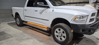

Added some Betts tanker lights for some ground glow but ended up being brighter than I thought.

Light between grill and front bumper you can switch between amber and clear

When I used to drive OTR I loved "Chicken Lights" all over the W900L & Spread Axle Reefer. Keeping them all lit up was a different story.
I purposely didn't get auxiliary switches so I wouldn't go crazy with lights.
Cluck Cluck Chicken Truck
