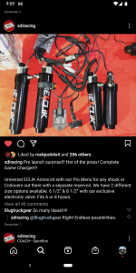

Well this is exciting... Very little info yet, but it's coming. Universal e clik for anything with a reservoir. Great for anyone who has already invested in the pin top, fox 2.5's or whatever.
I'm trying to get in touch with a friend who works for FOX and told me about this new system they had been working on.

They are developing the ram version now. The universal will be cool for custom jeeps and buggies, or those who have already invested huge money into dominator or pin top Kings for the 2500. I've been watching videos and it looks pretty legit.
Although he never even mentioned it, you can see the SDI clik is installed in his truck. Pretty impressive. Take my money already
