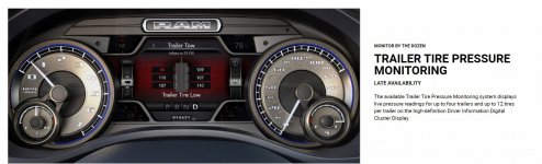

The TTPMS option isn't available in the online "build your vehicle" configurator, and my dealer was unable to find an option for it in their 2020 configurator. Rod may believe it is available, but it is not actually available, yet. The 2020 marketing material on Ram's web site still says "Late availability" (see picture below).

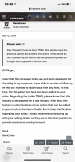

I had it on my order but when I received a printout (which RamCare won’t provide anymore) said it was dltd. Mark on this site from RamCare said my 50gal fuel tank was on it but the TPMS will be a late 2020 additionWell, I may be wrong about the 2020 TTPMS. I was looking at the 2019 capabilites page. Upon closer inspection, the 2020 capabilities page does list the TTPMS system as available.
Look at 2nd line from bottom. L8aP and see Marks response from RamCareWe should tell Rod Romain. He thinks the TTPMS was available on the late model 2019's (which it wasn't because I waited until August to get my truck).
