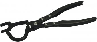

I was hoping it would be able to be installed without removing hangers...To get to the rear exhaust hanger with my tool.
Its just the rubber hangers, easy to pop off with spray lube and tool. Under $20 online, easier to use.I was hoping it would be able to be installed without removing hangers...
To close quarters back there? Won't just slip out of the isolators?Its just the rubber hangers, easy to pop off with spray lube and tool. Under $20 online, easier to use.
Yep, pretty tight and the hangers have little mushroom heads on there so hard to pop off.To close quarters back there? Won't just slip out of the isolators?
Right...I've been able to spray with silicone spray and push them through by hand.Yep, pretty tight and the hangers have little mushroom heads on there so hard to pop off.
