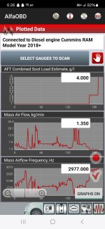

I'm literally pulling my hair out with this truck. Constant regens and building soot. Here's my graph from a 10mile drive on the highway. Started at 2Grams and spiked to 3grams in a matter of minutes. Pulled off on to the exit ramp and spiked to 4 grams. If I drive in town only I build no soot. Driving on the highway is the only time I build soot in the dpf.
