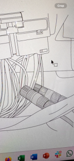

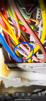

so according to AMP support some 2025's had a tan wire but some 2500-3500's have a white wire. the install manual doesn't call out the "white wire" option, but does sort of show that it is the wire next to the blue wire with white stripe. I told the person helping me that they might want to make mention of the location and possibility that the wire could be white as it was causing a lot of anxiety in the community regarding which wire is the TAN wire........ pictures below for reference.

My steps on my 25 3500 are still not working correctly. I currently have the blue OBD wire connected to the white wire circled above and the white OBD wire connected to the blue with white stripe. The only thing I have to do is connect the ground somewhere else, currently connected to the battery. In the pictures above is that a tan wire on the bottom left?
