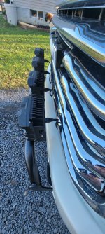

I'm using Morimoto BigBanger NCS light pods. I do not have it wired yet, trying to figure out the best way to route the harness for a clean install.
Just some pics of the pods temporarily mounted on the light bar.
I had the lights wired up today. Seeing how it's coming to the end of the year and I have a lot to get done before the white stuff hits, I opted to take my truck to JPJ Communications and have them run the harness and have them get it done. They primarily install equipment and coms in all of the EMS/LE and municipal vehicles in the local area. They did the wiring beautifully and have it run well out of the way of everything.
I do need to adjust the lights for them to be optimal with the light distribution. The backlight function works perfectly and dims down when the lights come on.
I will get some good pictures of everything tomorrow or the next day.1000001420.jpg
I had the lights wired up today. Seeing how it's coming to the end of the year and I have a lot to get done before the white stuff hits, I opted to take my truck to JPJ Communications and have them run the harness and have them get it done. They did the wiring beautifully and have it run well out of the way of everything.
I will get some good pictures of everything tomorrow or the next day.View attachment 78995
