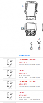

68526611AB if you have a CumminsHow do I know which of these part numbers includes the lane departure button? Is there a secret decoder I am missing somewhere?
