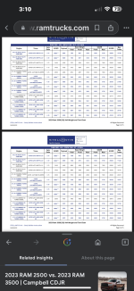

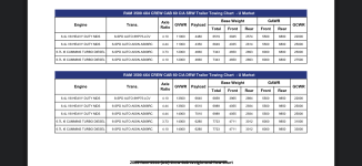

States on website anything over 13,500 pounds is considered DRW
