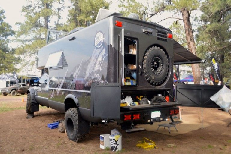

You could do mostly boxes, and then maybe someone could customize one so the spare slots into it, so it all looks cohesive.
Sort of like the spare on this EarthRoamer is recessed.

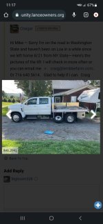

That's my old 2001 that I couldn't afford not to own. Bought it in Jan of 2021, it had 74000 actual miles. 8.1 v8 with a 6 speed manual 4x4.
I got to see if I liked dual wheels, hauling a TC. Needless to say that I did.
She's a good old girl, but she ain't a Ram.
