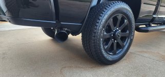

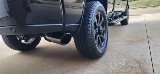

No, removed the resonator and back. Used the pipe left to construct a new exhaust and added a black tip. My exhaust guys machine would not bend 3 1/2" pipe. Cost me $100.
Can you post a photo by what you mean when they "tucked it up there" please. Ive checked your photos and build sheet and you have good photos its just Id like to see a angel from the side of the truck looking through the wheel well from your tire view and under how you bent the pipe.
He didn't bend any pipe. His machine wouldn't do 3 1/2 inch pipe. So we used the pipe we cut off from the resonator to piece it in with the new tip.
Got that tip adjusted. looks better now. And there is no drone i pull a 40ft camper that weight 10,600 lbs and zero drone.
View attachment 88591View attachment 88592
Much better look on the tip!
