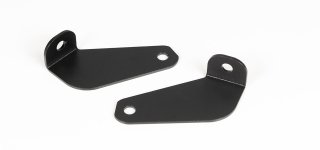

$69Ordered Colorado ZR2 Bison light bar brackets from AEV Conversions although it looks like they may work for me. Hopefully next week I am finally able to mount my Diode Dynamics Stage Series 30" white combo light bar on the nose of my adventure vehicle.
Note how the upper surface of the bumper rolls forward and slightly down - most normal brackets are designed for a flat surface. My AEV Premium Front Bumper shares a similar profile. Also, I want the light bar to be projected forward an inch or two so it does not interfere with operation of the clutch on the Warn 16.5ti heavyweight winch.

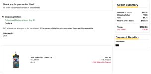

Copy of receipt for reference.
