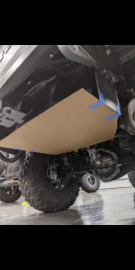

I bought the Titan Diesel spare tire tank and a 2016 1500 bed side with filler tube. Had a great body shop guy add the factory second gas door in the bed.
I purchased weld on 3/8 hose barb fittings and added them to the factory PW filler tube for the transfer pump. I had to add a one way value to the vent tube to keep the check engine light off. Install was very easy. Built a 3/8 plate skid plate with 1/4" hold downs.
For safety and mainly liability reasons Titan will only sell for Diesel trucks. Due to the fact the FMSCA and Federal DOT outlawed Gas tanks behind the rear axle after 2006. So I do not recommend this install. But it works. Screenshot_20221010-221258.pngScreenshot_20221010-221117.pngPXL_20201113_181622173.jpg
For safety and mainly liability reasons Titan will only sell for Diesel trucks. Due to the fact the FMSCA and Federal DOT outlawed Gas tanks behind the rear axle after 2006. So I do not recommend this install. But it works. View attachment 45413View attachment 45414View attachment 45415
Wow that is super cool thanks for sharing! How much capacity is the rear tank?
Looks cool, but the last thing I'd want to do is add any weight behind the rear axle on my PowerWagon.
Adds 30 gallons of gas. Yeah, the wagon scales out at 11,650 split 40/60 front to rear heading out W/ 62 gal fuel, 30 gal water in the side tanks, a grip load of tools and all supplies to last a week plus.
