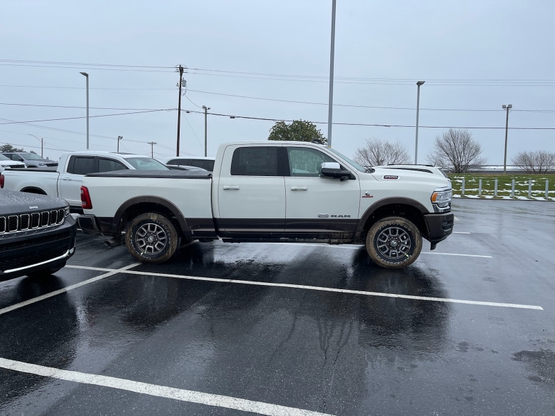

With thuren 2" Track bar![]()
Anything done to the rear? What's the height in the rear in comparison to the front?
Any rubbing? Stock rear? air bags?STOCKView attachment 57060

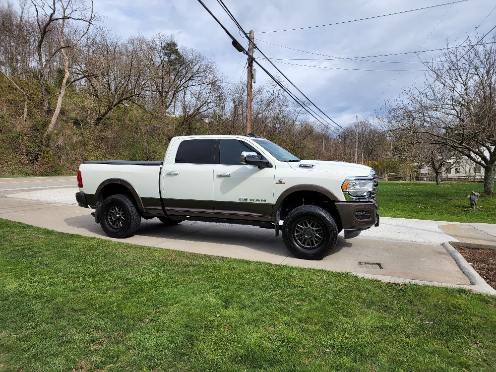

With Thuren leveling kit (w/Fox 2.0 shocks), adjustable Thuren draglink, Thuren/King OEM steering stabilizer
37x18x12.5 Toyo Open County R/T w/Method HD NVs
Looks nice! What’s the height difference of front and rear?Stock rear, no bags. Very minor trimming of the plastic inner fender, but no rubbing.
If I were to do it again I would have gone 17s, but aside from that I love the setup.
