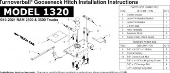

With the BWGNRK1320 Turnoverball installed in the factory 5th wheel prep I have read I will need to slightly modify the locking handle bracket that comes out of the Center Section to use the oem vertical studs as the driver side front stud hits the bracket in stock form.
If anyone has any pics of this mod that would be great.
i just did this swap, it wasnt too difficult. did not have to lift the bed. The b&w bolts right up where the oem was. I did have to cut off the driver side front vertical bolt for the latch assembly to clear. it was a pain due to the location of it but i managed with a angle grinder. i did not drill holes for the chain hooks, i also ordered the oem curt puck mount hooks. the only disappointing part is the cheesy plastic cover wont fit in the bed to cover the hole but doesnt matter since i will have the ball installed most of the time anyway. if anyone needs an oem gooseneck bracket mine is for sale.

I'm planning to make this swap. I haven't yet looked at the factory hitch setup. So, I'd like to confirm...
1. Is there room to/do you need to reach the top of the factory bolts for removal or installation?
2. After removing the factory hitch, are there essentially four dangling bolts you use to attach the B&W hitch?
3. You skip the B&W welded nut/plate "fastener blocks" altogether, right?

1.You do not need to access the top of the bolts, they will stay in place and have welded flanges to keep from rotating.
2. Correct. You remove and reuse the factory nuts, the bolts stay in place and dangle so to say.
3. Also correct. You do not need the supplied nut plates or bolts. I resold mine with my oem hitch.
