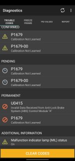

Upon restart i got a trans code Stating incomplete trans calibration( p1679) which makes sense. But now the truck is not ussable as the trans shifts horribly, huge shift flares on gear changes. I only drove around the block and proceeded to try many times to quick learn the aisin. All attempts go exactly as the first one.
Am I missing something? Has anyone completed this on the aisin with the alfa obd? If so could you point me in the right direction?
