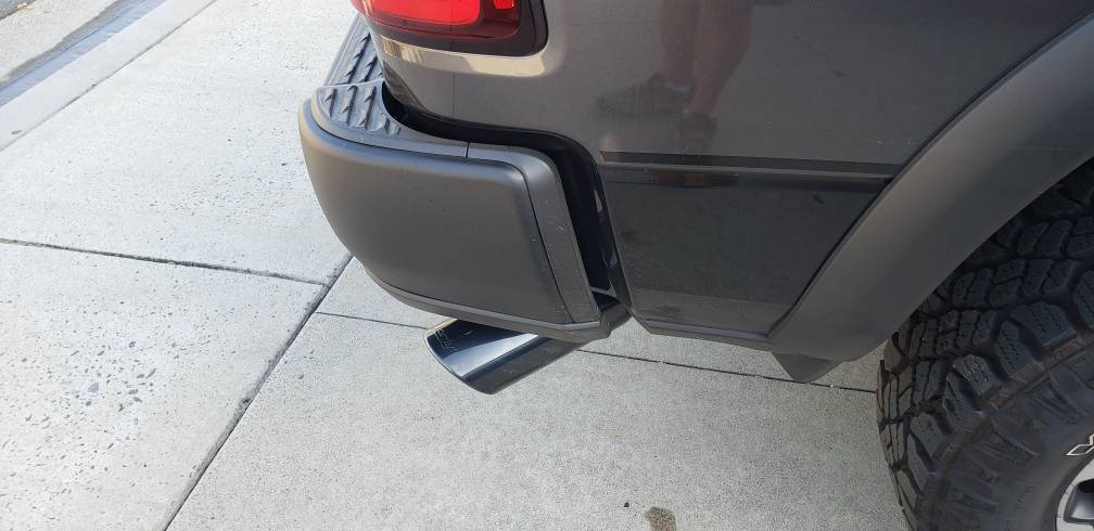

Jj517
Joined
Jul 28, 2019
33
21
Can you let us know if the noise disappears after you have your new exhaust installed, and/or what your dealer states? That may give us one process of elimination item before hitting the dealer!
Sorry for the late response.
I have noticed it lately when I first put on my exhaust it did it it has not done it lately but I usually turn it on inside the house in the am I will keep an eye out for it
Sent from my SM-T830 using Tapatalk
Jj517
Joined
Jul 28, 2019
33
21
I have not noticed it lately when I first put on my exhaust it did. It has not done it lately but I usually turn it on inside the house in the am I will keep an eye out for it
You can hear what almost sounds like a leak but it's not the screeching sound.

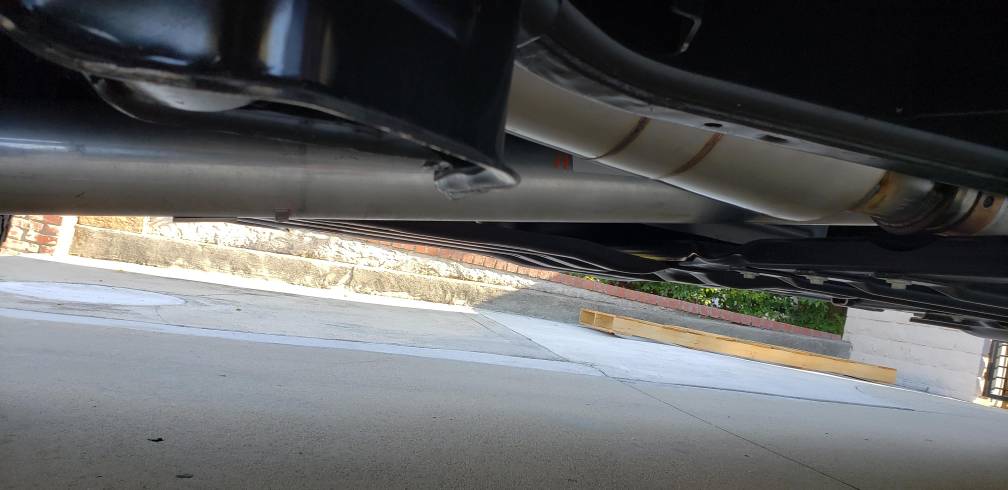

tpk0999
Joined
Mar 5, 2019
91
39
If you could video the sound it might be helpful. I know in the past their Y pipe was an inefficient design. 2 pipes smashed into 1 single pipe. By smashed I mean squashed. An inefficient design that if they changed or don't manufacture correctly could cause a whistle.
With that being said I hope mine doesn't whistle when I get it. I always change out the exhaust due to the fact (older design) it's usually whisper quiet. I was pleased that this truck sounds way better than in the past though.
