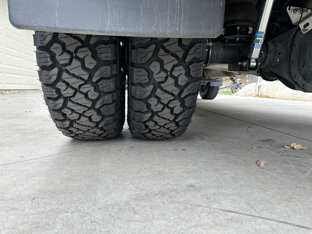

Got a new tire size for the stock wheels boys. Kenda Klever in 35x10.5r17. I think they look amazing!
I added these along with a Carli 2.5" level, some 2" rear blocks and airbag spacers, and Bilstein 5160 reservoir shocks up front with 5100s in the rear.
Completely transformed the truck. LOVE IT.
Here they are with no rear spacer.
I didn't like it so I added a .25" spacer and now im comfortable with it.
Did you have to cut the studs since only a 1/4" spacer was used in the rear ?
