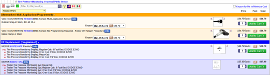

Rock Auto shows 4 listings. Two Continental part numbers and two Mopar part numbers. It does show distinct part numbers for sensors for the truck and sensors for trailers, with trailer sensors 50% more expensive. I'm planning to pop the set included at the factory into a future travel trailer we're buying later this year or next, or possibly saving them for a future car hauler for the Chrysler and our '29 Ford, and get the TireLinc system for the travel trailer since Grand Design preps its Imagine trailers for that system.
But, eventually I will need replacements for whichever trailer (or both if the RAM system works well enough for us), so if we know who is the OE supplier (Schrader? Continental?), that would help saving costs down the road.
