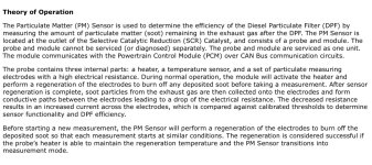

The sensor measures the amount of soot exiting the DPF and SCR. It sits at the outlet of the SCR chamber. It’s looking for excessive soot in the exhaust stream. The DPF is almost 100% efficient at trapping soot so theoretically nothing but a minuscule trace amount should be getting through. If the PM sensor detects more soot than what the calibrated threshold is, it trips a code for a failed DPF (cracked internally or a breach in the pressure vessel allowing sooty exhaust to bypass the system and exit to atmosphere)I have been told by some that the missing sensor measures soot levels passing thru the DPF like if ithe filter was damaged or has a hole in it??? Something Calif wanted who wants to ban diesels altogether.

It does not measure soot, only NOxThe sensor measures the amount of soot exiting the DPF and SCR. It sits at the outlet of the SCR chamber. It’s looking for excessive soot in the exhaust stream. The DPF is almost 100% efficient at trapping soot so theoretically nothing but a minuscule trace amount should be getting through. If the PM sensor detects more soot than what the calibrated threshold is, it trips a code for a failed DPF (cracked internally or a breach in the pressure vessel allowing sooty exhaust to bypass the system and exit to atmosphere)
Sorry John but your information is wrong.It does not measure soot, only NOx
Selective Catalytic Reduction\DEF Process - When NOx reaches a certain level DEF is injected into the SCR to remove NO2/NOx. The NOx levels trigger the DEF injection and also determines the quantity of DEF.
Trucks shipped without the SCR sensor are set to use a particular amount of DEF to satisfy the EPA (not California). When the sensor is finally installed the amount of DEF used should be less because the sensor will determine when and how much DEF is needed.
Yes, the Y43 recall. You are correct, the recall makes it sound like a DPF sensor. The truck is shipped without the sensor in the SCR. It has a sensor in the DPF. The recall installs the SCR sensor, referred to as a Particulate Matter SensorHmm. My recall notice says it's a PM sensor. Are you talking about the Y43 recall?
The sensor is installed at the outlet of the SCR chamber, but does not measure NOx or have anything to do with DEF dosing or consumption. It’s there to count “particulate matter” which is soot. The only reason Ram was successful in getting CARB to sign the MOU and allow them to sell the trucks without the sensor in place was because the PM sensor had no direct influence on how the entire emissions system meets targeted PM and NOx standards. The system functions exactly as all other model year trucks do, with the exception that it doesn’t have the ability to check the emissions for excessive soot exiting. They were hedging their bets that the systems would function well enough for long enough that ram could obtain the sensors within the year or so and have them installed before any of the DPF’s started failing. That’s why when the sensors first became available again, they issued the Y43 recall to cab & chassis trucks first, knowing full well the commercial trucks would rack up mileage faster than the pickups.Yes, the Y43 recall. You are correct, the recall makes it sound like a DPF sensor. The truck is shipped without the sensor in the SCR. It has a sensor in the DPF. The recall installs the SCR sensor, referred to as a Particulate Matter Sensor
Prior to the recall being completed there is one sensor after the SCR, it's a NOx sensor. After the recall there are two sensors past the SCR, a particulate sensor and a NOx sensor. As others have stated the recall has nothing to do with the SCR/NOx.Yes, the Y43 recall. You are correct, the recall makes it sound like a DPF sensor. The truck is shipped without the sensor in the SCR. It has a sensor in the DPF. The recall installs the SCR sensor, referred to as a Particulate Matter Sensor
Well that makes sense. I did not know that.Prior to the recall being completed there is one sensor after the SCR, it's a NOx sensor. After the recall there are two sensors past the SCR, a particulate sensor and a NOx sensor. As others have stated the recall has nothing to do with the SCR/NOx.
