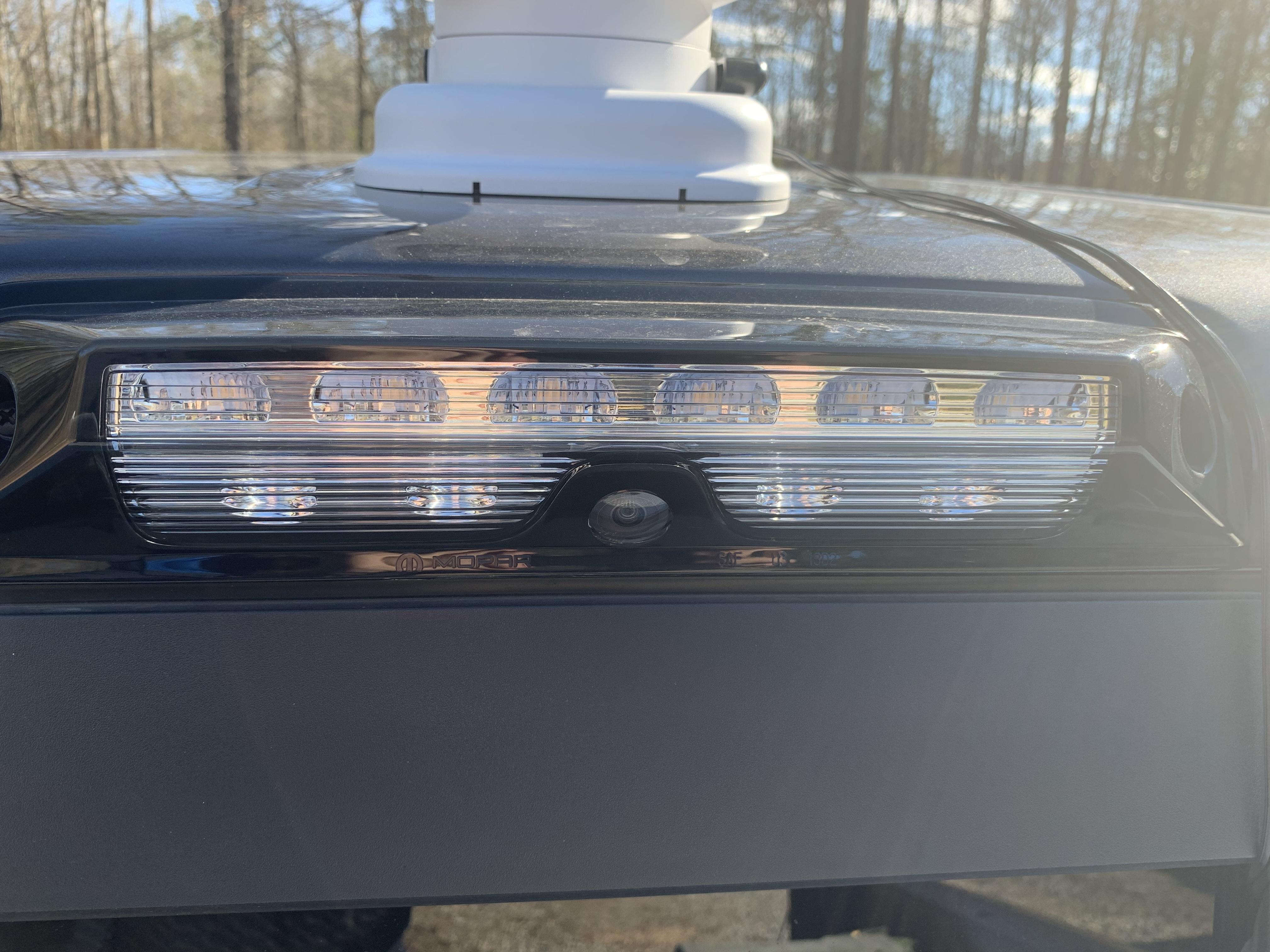

I thought I'd revive this thread. Has anyone recently purchased a third brake light replacement that doesn't stick out as far as the camera? The item from the Amazon link earlier in this thread is no longer available.
It’s ok during the day. Worthless at night.
Also, my window isn’t very clean at the moment.
I should explain. I don’t have bed lights and the glare of the cargo lamp makes seeing into the cap difficult. I am considering adding some kind of bed light independent of the cargo light to provide visibility into the cap at night.
It does allow me to check the dogs while under way
