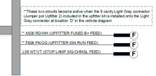

Also found some poorly terminated wires above the spare tire. Anyone have a clue to what they are for?
Those blunt cut wires are described in the upfitter documentation for the chassis cab.
The red/white wire is battery power.
The pink/orange wire is ignition (run) power.
The white/violet wire is the stop lamp signal.
The battery and ignition wires are dead until you plug in the gray upfitter jumper into the gray upfitter connection that is located in the cab near the firewall behind the light switch.
