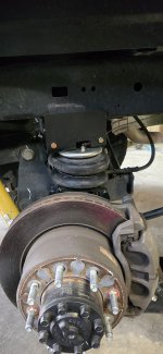

Installed air bags over the weekend with the compressor and wireless setup. the check valve was cracked either from the factory or i did it when i tightened. i don't know so have to order/get it replaced. removed that and filled it off the bumper valve and i apparently have a slow leak somewhere. will trace it out once i get the check valve back in.

Bummer on the leaks. What bag setup?
What are the lines? Poly with push lock fittings?

i pretty much know what i did wrong. i was lazy and used cutters to cut the line rather then a good blade. so they are likly squished rather then round. once i get the check valve ill verify each connection. the one that will suck is the one that goes into the bags as my fingers may be too fat to get in there lol. but thats thankfully just 2 bolts to undo per side. its a very slow leak so i can put 10 lbs in and in like 12 hours its down to say 5lbs.
i can fix it but its a monsoon for the next 3 days so ill likly get to it this weekend when its nice out.

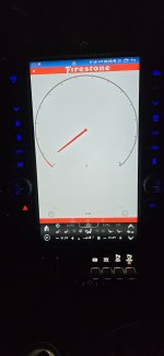

Finished the Air bag stuff last night. pulled every line and recut and replaced. flipped my compressor around and bolted it in more securely cause apparently maryland roads and self tappers dont mix. reran my air line for the filter to a better spot. discovered the bumper mounted air fill line was being harrased by my spare tire which was producing a large leak so had to look at it and go stop it. it stopped.
the app is cool, don't even need it on my phone. just added it to the radio i installed last week and I can monitor it when I'm not watching tv lol.

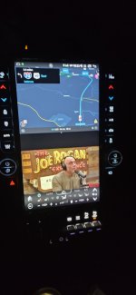

How did you get video to play on that bottom screen?
