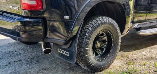

Yep, the fronts are more complicated. If my Mopars weren't already mounted I would send you a paper cutout. I took wheels off and mounted like you, with nuts and bolts. Not an easy takeoff. Sorry about that.Thanks @John Jensen I went through numerous images to find a layout I liked, even then, it took some messing with the cardboard to get the height on the body correct so it looks 'right', and at 14" wide, they should be fine for the stock sized tires I plan on running anyway.
The fun part is going to be tomorrow when I start on the front flaps... the cutouts on those are a bit more 'complicated', but measure 3-4 times before cutting, right?

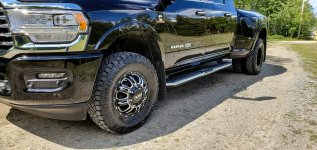

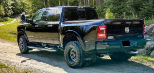

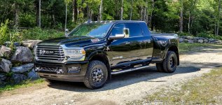

That tire size looks perfect.Today was a nice day to take pictures. Here are the new wheels & tires installed earlier this week.
Tires: Nitto Ridge Grappler 255/80R17
Wheels: Ultra Motosports 049 Predator Dually 17x6.50
Inner rear wheels: Steel 17x6.50
New TPMS Sensors installed.
Hypertech speedometer calibrator: set to 32.00 for perfect match with GPS.

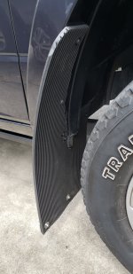

And the fronts are mounted... and yeah, they took a bit longer as the front inner fender has some interesting bumps.
Thanks to @1FastHemi for posting the original idea.

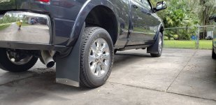

4- 24x30 Composite mudflaps shipped from Northern Tool for just over $70.
4 weights from Bores MFG for just over $50.
The most time consuming portion was getting the cardboard mock-ups correct... the rears were rather easy, the fronts took a bit of shaping.
Jigsaw, drill, and levels were all I used to get these mounted... and I reused the OEM screws (I did add one bolt to each on the inner fender to stop it from flapping/sagging)
I think time/money wise it is close to a wash on building vs buying... just really depends on the individual.
Looks great. I probably would rivet the weights on, or used T-nuts.
