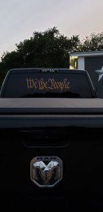

You’re doing it wrong. Buy a 3m eraser wheel. Put it in your cordless drill. Go.I started debadging the truck today. Got the drivers side done, and called it good enough for today. If I went any further my finger tips would have been quite displeased with me,
