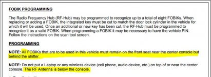

Jimmy per the instructions I received with my remote starter kit it says the RF Hub is located below the center console not on the back wall. Just and FIY
That’s an RF Antenna, not the RF Hub. The Hub (module) is on the back wall. The antenna detects that the fob is in the cab.
