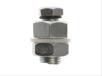

Thanks, starting to sound like a lot of cash for the future convenience of a drain plug. I'll probably weld a bung into the OE pan and call it a day.
If that’s the route you prefer, Dorman makes a bung that just requires you to drill a hole, and then simply bolt in the drain plug.
About as easy as it gets.
