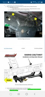

How did you mount the horns in the front they have that dampener
Dead center under the cab. Pointing out the side. Fit perfectly in the space.
