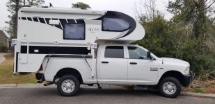

I have a 2018 Tradesman 2500 6.4 4x4 Crew Cab with the 6sp tranny and 3.73 gears. Payload is 3300 and max towing is 13100. I do not tow right now but haul a 2500 lb truck camper and the truck actually rides better with that weight than when it is empty. I average 11-12 mpg when loaded up. I purposely went with the Tradesman for the extra payload but I really like having a basic truck instead of a higher trim level. Vinyl seats and floor are way better for my use of the truck and I do not worry about the interior like I did on my Laramie with leather and carpet.
