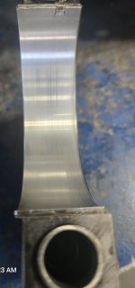

dealership called me this moring my truck was up on the rack. I was able to get in and inspect the bearings and oil pan myself. There were no wear by finger nail on the ones I saw, but by visual you can see wear marks in my opinion. Coming from a machinist family background its the first sign of failure. There was specs in the oil pan but pretty small, but for how many oil changes I've had in the last 1000miles you should be able to drink it. Dealership will send photos to me and Ram we will know eventually. Seeing how they replaced rocker arms and push rods due to fuel this has to be next I hope.

Yep, I agree. I’m no machinist but that sure looks like excessive wear to me. They’re going to reimburse you for that if they agree there is damage?
What is that a picture of a gouge on, the crankshaft? I can’t tell what it is in the picture.
I did show a buddy of mine that was a Master tech. He said it looked pretty normal for the most part but some parts dont look quite right.
few mechanic friends say they look normal. We will wait to see what photos the dealership comes up with.

My self would hate if my oil pan had that much sparkles in the bottom of the pan, too me one of the rod cap photos likes like it has good scratches in the bearing, did they at least pull one crank cap, preferable the thrust bearing cap?
They should have and should be sending me photos.
I guess I’ll be the oddball and say that for the issues you have had I expected much worse. I was expecting to see copper on them.
