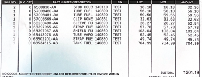

Pretty much everything in this schematic - https://store.mopar.com/oem-parts/mopar-fuel-tank-68534615ab ; around $1200 worth. We compared it with the existing part numbers and they were all different; which makes sense if you are going to be adding ~15 gallons to make everything reach. Here is the initial list we came up with; they said they added a few other things they thought they might need; which we will take off the invoice if not used ybyUNdC5RM7UR5Xe.png

Don’t forget fuel pump 68490270AB (if you want the fuel gauge to read correctly)
So. If I understand correctly. Nothing is really reused. It’s a completely new tank pump etc. to do the swap? Assuming it works.

Question, how would it effect the gauge if it is the same depth or very close? Shouldn't half tabk be half tank no matter how long the tank is?
