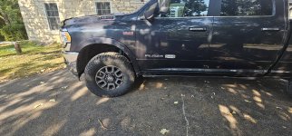

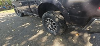

I ended up purchasing five wheels & tires from Costco. I went with Velox's spiral-forged 20X9R20 +10mm offset Grenade wheels and 35X12.5R20 BFGoodrich All-Terrain T/A KO2 tires. I started with four tires and five wheels. Once I discovered the 35X12.5R tire fit (barely) in the spare tire space, I purchased a fifth tire. The only rubbing (minor) that occurs is when I turn the wheel to left all the way and hit a bump. Other than that, all good. FTR, my truck is a 2024 RAM 2500 Limited with the optional Automatic-Leveling Rear Air-Suspension. If over time I notice more rubbing, I will add a leveling kit.
