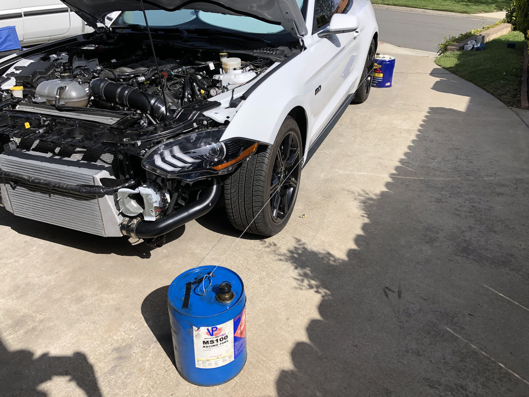

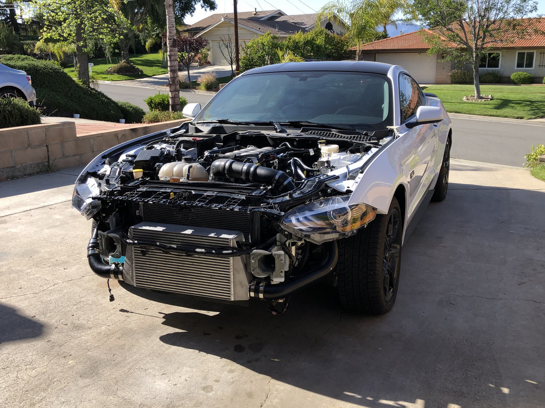

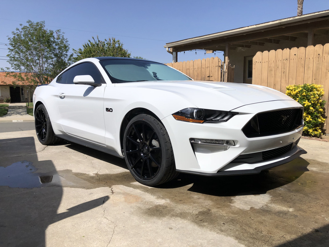

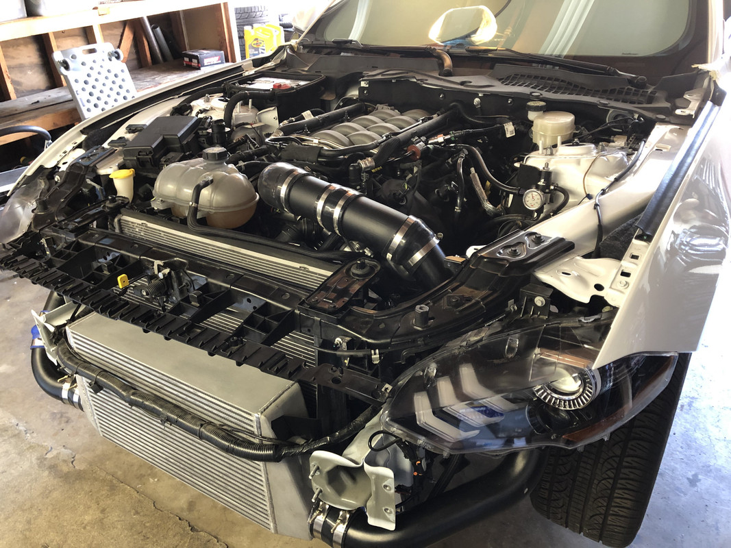

Finished up the motor build/install on my Mustang. Got lots done this weekend.
--Fabbed up a quick oil primer to ensure she was oiled for first start
--bought a new set up shoes
--Had to align the front end due to installing a tubular K member (suspension bolts to K member)
--Installed front bumper cover
She's alive!! Runs great. Feels good driving this girl again and THANKS TO BRANDON, this is now my most cost efficient vehicle to drive being it burns straight e85 at $3.49/gallon.
