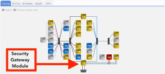

They're basically building the splitter and bypass into one unit, however, their bypass doesn't clip firmly into the factory location. We have one on the other 2500 and plugging OBD2 things into it you've got to hold it in place or it'll pop through the dash opening.
The reason it cannot communicate with the radio is the SGW module. The SGW module protects the OBD2 port and isolates the radio from the canbus. You can do a full SGW bypass, however, it would leave your truck open to attack via connected services (unless connected services deleted) and it will cause issues for the dealer.
