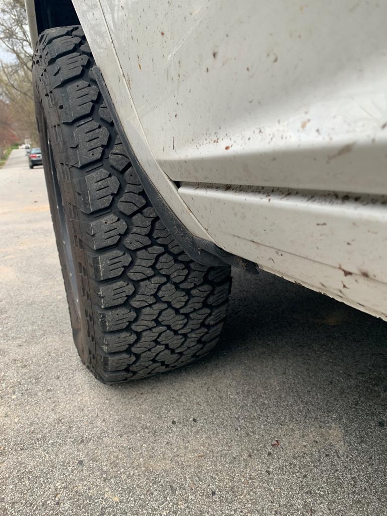

I’ve been running General Grabber AT/X tires (285/65r18) for almost 100,000 miles on my 1500. They’ve been awesome. I’ll probably put them in the 2500 when the time comes.
