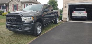

I installed N-FAB Predator Pro Steps. It hugs tight but does include 4 steps that stick off the panel. I wanted something that was low profile but easy fory wife and kids can get in and out easily. Works perfect for my 6 yr old daughter.
Sorry.. had trouble posting.. but i got the standard RB10s installed them today.. look decent.. best part about them is i can access the bed because they extend past the rear door.. pretty flush.. they don’t look like wings either..
