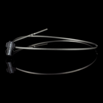

The short one is like 15", the long one is like 43".
It's pretty obvious the short on can't reach down into the trans.
Long (new) locking stick on the left. Factory non locking on the right. The new tube (right) has a roll in the neck.
Short (initial recall) locking stick on the right, factory non locking on the left.

Suncoast makes a locking dipstick for the 18 and older 68rfe. It's a little longer and the marks are wrong. It's better than the ATS solution, cheaper and a better short term solution if you can find one (just need to use the factory dipstick to check levels).
Edit -> this is just a short term fix until the dealer can perform the actual recall.
There is a TSB if you have the short dipstick with locking handle you can go to dealership and request a long dipstick free of charge. The dipstick tube is the same length as the dipstick tube with short dipstick.
