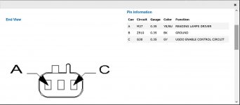

The feed for the homelink module is the UGDO enable circuit on the BCM, and it will need to be enabled with AlfaOBD. I don’t think a visor exists that has the vanity light but not homelink, but it won’t be too difficult to add that circuit if you get the correct visor.
Would you happen to know what circuit would be used? Or where to find the information?

It looks like they use power from the overhead console so you shouldn't have to enable anything. If you want to use the factory wiring for it you would probably have to enable it like Jimmy said. The homelink itself is a self contained unit, just needs power.
Actually looking at the plug in the infotainment video it looks like it's a 3 pin. What does enabling it in alphaOBD accomplish if it's a self contained unit?
It enables power on that UGDO circuit..... But since the infotainment just grabs power elsewhere you don't need to do that. The 3 wires are power for the UGDO, Power for the lighted mirror, and gnd.

After I Posted the question I actually figured it out.
12v constant for mirror
12v ignition for homelink
Shared ground
Shared ground
I don't see where anyone replied to this question. Lets assume someone wishes to wire the sun visor to the BCM, as it would have come from the factory. Is there a MAP with all of the pin locations on the BCM?
