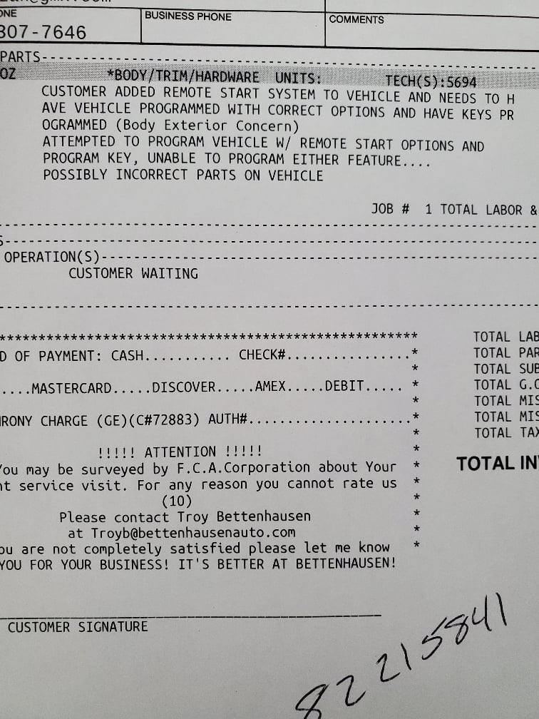

Here is the note from dealer
Did you add anything to the truck? Service bite says you added remote start?
Might try another dealer, tell them to program your fob and add the sales codes for remote start and tailgate. Nothing more, nothing less.
If they are like my dealer, “they’ve never heard of that being done, they will charge $xx.xx either way” will be the speech
I told him I want the sales codes added he asked "why?" So I told him. Then I told him don't worry about it just program the fob and still he said they can't do it.
You guys won't believe this. There is no battery in it
