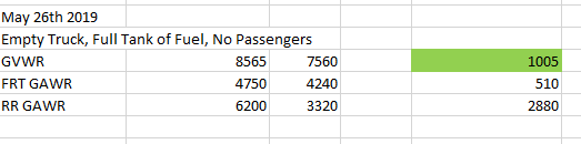

Pretty hard to mess up taking a truck across the scales and weighing it and comparing that against GVWR (GVWR - Weight Slip = remaining available payload)
- 2 engineering degrees and needing to do the above is included in job description to ensure any and all testing is within legal and as designed specs
Again the sticker was not accurate even with full tank of fuel as built (but it was close)
Nope still dismal payload numbers (2019 here, so cant use the argument they bumped it up with the refresh)
GVWR - 8565lbs
Payload Sticker - 1083 lbs
First weigh empty truck, full fuel tank, no passengers - 7560 lbs
Available payload 1005 lbs (again i am not in the vehicle and nobody else is)
***sticker is off by 78 lbs just by filling up fuel tank**
-no occupant included in payload sticker
by my math that 78 lbs indicates sticker-ed with about 1/2 tank of fuel

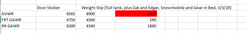

Third weigh - 8900 lbs
*tools, sliders, skid plate, front diff guard, off road lights, full tank of fuel, snowmobile in bed of truck, me as driver and dog in backseat (St Bernard)
Available payload - (-335 pounds) overweight
I can pull out my binder and take pictures of the other 2 weigh slips if i need to further prove myself

Nah, no need to prove anything, When I asked you earlier if you weighted your truck, you didn't reply to that and your reply was a little confusing.
But yeah it all makes sense now, my bad, thanks for clarifying.
