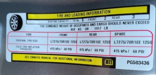

Please Post Payload Sticker from Driver's Door Jamb.
the 50 gallon tank and AISIN trans is about all that isn't in the signature.sticker.jpg
Well that doesn’t leave you much wiggle room, eh?
Not a lot, but more than I need with just the two of us. I don't carry much of anything inside the truck - that's what the camper is for and it's weighed fully loaded. Additionally, that pin weight was taken with the fresh water tank empty, that's 500 pounds at the rear of the camper that could be added which would lower that pin weight a bit. If push comes to shove I could always unload the basement and forward storage. The camper has a 300 pound rated receiver in the back and I've got plans to install a spare tire rack there and move the spare from the front storage to the rear.
I'm more concerned about sag than anything else. I'd just as soon not have to install air bags if I can avoid it.
Sorry we're getting off topic here, but with a 5er on a 2500 you may want bags just for stability. The 2500 springs are mounted inboard of the frame and don't provide a lot of lateral stability when you have a heavy load up high (like a 5er).

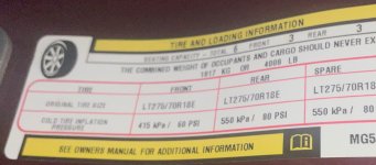

2022 Bighorn 2500 4x4 6.4 hemi short bed

Dang. I had 600 lbs more capacity in my 1500 o_O
Haha yep! The 1500 Limited that I had initially ordered (until I decided that a Power Wagon was what I really wanted) has about 60 lbs more capacity.
I knew that it was more likely I would do some mild off roading than tow or haul anything, and wanted something big (heavy duty). I figured that the softer suspension would make it okay for a daily driver.
I drove with the stated psi (60f/65r) for a bit and noticed that big bumps (pot holes and such) handled a lot smoother than my 2015 Subaru Legacy (that I got rid of), but I could certainly feel the smaller bumps a bit more.
I aired down to about 47f/44r and now the smaller bumps are about on par with the Legacy.
